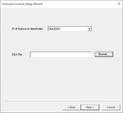

Licence Setup Wizard - Deactivate Licence page
The ID of licence to deactivate dropdown box only appears for network licences if there is more than one network licences present. Select the soft licence to deactivate.

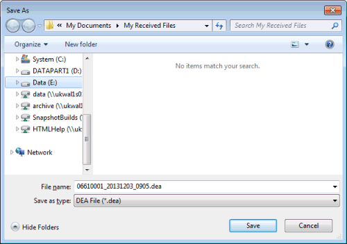

Click on the Browse button. A standard Windows Save As dialog is displayed, with a suggested path for the DEA file.
Saving the DEA file
Leave the location as is or browse for the desired location and click on the Save button. The DEA file is automatically generated in the selected location (at this point, the licence is deactivated on the PC).

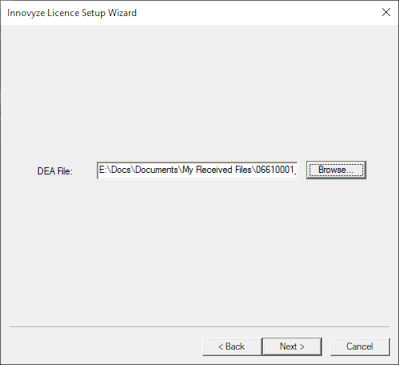

Back on the Deactivate page, the DEA File box now shows the path of where the DEA file can be found on the PC.
Dialog showing the location of the DEA file
Click on the Next button. The Finish page is displayed. Click on Finish to complete the process.
