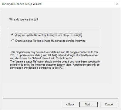

The Update Page is displayed when the Manage dongle upgrades option is selected on the Welcome Page of the licence setup wizard.
Licence Setup Wizard - Update page
Applying an update file
To upgrade the dongle, select the Apply an update file sent by Innovyze to a Hasp HL dongle option and click Next. The Apply Update Page will be displayed.
Creating a status file
Under certain circumstances (if there has been a problem with a dongle upgrade, or a dongle upgrade has not been properly applied), it may be necessary to provide a .c2v status file to Innovyze.
To create a status file for the dongle, select the Create a status file from a Hasp HL dongle to send to Innovyze option and click Next. The Create Status File Page will be displayed.
