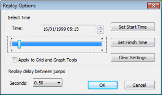

The Replay Options dialog is displayed when you click the button on the Replay Toolbar or selecting Results replay | Replay options from the Network menu. This dialog allows:
The current simulation time is shown in the Time box. When using TSDB data with a run origin specified, the current simulation time is displayed followed by the time of the run origin relative to the current simulation time.
Set the current simulation time by moving the slider bar or using the up and down arrows next to the Time display.
Change the start and finish time for replays by setting the current simulation time and then clicking the Set Start Time or Set Finish Time button. On the slider control, the time limits of the current replay are shown in blue. Any parts of the simulation that fall outside the current replay are shown in white.
To remove any changes you have made to the time selection and set the replay start and finish time back to the start and finish time of the simulation, click the Clear Settings button.
Check the Apply to Grid and Graph Tools box to apply the selected start and finish times to results graphs and grids. This setting applies to:
When you click OK, the simulation will be paused at the current simulation time shown in the Time display. All the views of the simulation are updated to show the current state of the network at the selected time.
To adjust the replay speed of the simulation, use the Replay delay between jumps dropdown.
