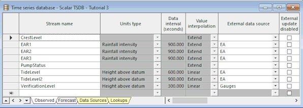

Scalar TSDB
An example of a configured scalar TSDB

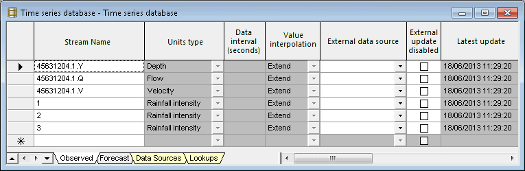

The Observed and Forecast pages contain information about observed and forecast streams respectively. The Data Sources page contains details of the corresponding external sources while the Lookups page is used to map alphanumeric text, in the imported time varying data, to numerical values which are recognised by InfoWorks ICM.
There are two types of stream: observed and forecast. Observed streams record real world measured values whereas forecast streams record predicted values.
TSDB
The following stream properties apply to both observed and forecast streams unless otherwise stated:

Stream name
The data stream name.
When using Simple CSV format as the data source type, the data stream name will be used to identify the file containing the live data feed by default.
When using FW Format1 (FloodWorks Data Transfer File Format 1) as the data source type, ensure that each individual data stream in the multiple stream FloodWorks file is assigned to a single stream name in InfoWorks ICM.
Units type*
The type of data measurement.
Data interval*
The expected maximum time interval between successive values. This is used to determine if values are missing at any given time. If each value is valid indefinitely (until superseded by a later value) then set this to 0.
Value interpolation
The value interpolation method defines how values are interpolated when needed at times in-between non-missing values. The options are:
  • Extend - a step function will be used between non-missing values
  • Linear - linear interpolation of values will be carried out between non-missing values
Note that the engine will always use Extend for Rainfall, even if the method has been set to Linear, and will always use Linear for other items e.g. flow, level. The Value interpolation only applies if interpolation is needed when generating the data sent to the engine, for example when you have two flow profiles to go into the event file, but these have different time steps and so must be interpolated to a common time step.
When using a data stream to update the state of an existing model, the Value interpolation field must be set to Linear.

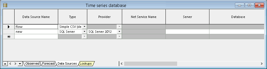

Data Sources page
Data sources are required to connect to external systems to get the time series data for the streams. For example the folder name where RADAR forecast data is stored or the connection string required for a RDBMS such as Oracle.
Note: Data sources are updated sequentially, so if the update of one data source is dependent on the update of another then it should be put before that data source in the list on the Data sources tab. This may occur, for example, if the scripts run third party models where the results of one model feed into another.

Data Source Name
User defined name for the connection.
Type
Dropdown list of supported database types:
  • JET
  • Note: It is not possible to use "access" as an external data source when carrying out automatic simulations using the Innovyze Live Server due to incompatibility of JET databases with x64 applications.
  • Oracle
  • SQL Server (SQL 2005 /2008 /2012 supported)
  • PI
  • PI WebAPI
  • ODBC
  • Note: ICMLive requires the classic PI OLEDB provider and not the Enterprise OLEDB provider. Both providers can be installed side by side and do not interfere with each other. However, some of the functionality required by ICMLive is only available through the classic provider.
  • Simple CSV (Deprecated)
  • Batch CSV
  • FW Format1
  • SOPHIE (Pre)
  • SANDRE (XML)
  • iHistorian
  • ClearSCADA
  • EA RestAPI
  • ADS Telemetry
Provider
Enabled when Type is set to SQL Server.
Available options are:
  • SQL Server 2005
  • SQL Server 2008
  • SQL Server 2012
