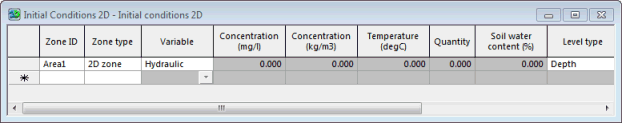

Initial Conditions 2D Grid Window
To open an Initial Conditions 2D Grid Window for editing, either drag the Initial Conditions 2D object from the Explorer window onto the main window background, or right click on the item and choose Open from the popup menu.
Field Description
Zone ID
Name of 2D Zone or 2D IC Zone
Zone Type
Select the type of zone that the initial condition is to be applied to from the dropdown:
Variable
Select the type of variable to be set from the dropdown:
  • Hydraulic - allows initial depth/elevation, speed and direction values to be set for a 2D zone or hydraulic IC zone
  • Infiltration - allows initial soil water content for a 2D zone or infiltration IC zone to be set
  • Water Quality Determinant - allows initial concentration of selected water quality determinant for a 2D zone or water quality IC zone to be set
Concentration
Enabled when Variable is set to a water quality determinant type.
Initial concentration of determinant.
Concentration
(Salt)
Enabled when Variable is set to SALT
Initial concentration of salt.
Temperature
Enabled when Variable is set to TW_DIS
Initial water temperature.
Quantity
Enabled when Variable is set to PH_DIS or COLDIS
Initial pH or coliform value.
Horton soil water content
Enabled when Variable is set to Infiltration
Initial soil moisture content for use when using the Horton infiltration model.
Green-Ampt soil moisture deficit (%) Enabled when Variable is set to Infiltration
The initial soil moisture deficit (i.e. the difference between soil porosity and actual moisture content) in the Green-Ampt Model. The percentage entered must be greater than or equal to zero and less than or equal to 100.
If no Green-Ampt soil moisture deficit (%) is specified as an initial condition 2D, then the soil moisture deficit is set to zero, and the ground is assumed to be saturated.
DefConLoss initial deficit Enabled when Variable is set to Infiltration
The amount of water required to saturate the soil layer to the maximum storage in the Deficit and Constant Loss infiltration model.
Level type
Select an option from the dropdown:
  • Depth: level relative to ground level
  • Elevation: level above datum
Depth
Enabled when Variable is set to Hydraulic or Bed sediment and Level Type is set to Depth
Initial height of water at the centroid of the mesh element relative to ground level when Variable is set to Hydraulic.
Initial thickness of sediment layer at the centroid of the mesh element relative to ground level when Variable is set to Bed sediment.
Elevation
Enabled when Variable is set to Hydraulic or Bed sediment and Level Type is set to Elevation
Initial height of water (above datum) at the centroid of the mesh element when Variable is set to Hydraulic.
Initial height of bottom level of sediment layer (above datum) at the centroid of the mesh element when Variable is set to Bed sediment.
Speed
Initial velocity of water in mesh element.
Direction
Initial direction of flow in mesh element.
Angle in radians from due East.
Layer
Enabled when Variable is set to Bed sediment
Layer to which the initial conditions are to be applied:
  • Non-erodible
  • Parent
  • Deposited
  • Active
Layer composition type
The method by which composition of layer is to be entered for each sediment fraction:
  • Mass concentration (kg/kg)
  • Volume concentration (m3/m3)
Layer concentration sf1
Percentage of initial mass of sediment fraction 1 if Layer composition type is set to Mass concentration.
Percentage of initial volumetric concentration of sediment frPercentage of initial mass of sediment fraction 1 if Layer composition type is set to Mass concentration.
action 1 if Layer composition type is set to Volume concentration.
Layer concentration sf2
Percentage of initial mass of sediment fraction 2 if Layer composition type is set to Mass concentration.
Percentage of initial volumetric concentration of sediment fraction 2 if Layer composition type is set to Volume concentration.
