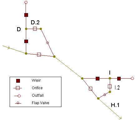

The following example of Real Time Control compares the volume in two tanks and regulates the discharge from these tanks so that a maximum flow is not exceeded.
Under this scenario, the flow in conduit H.1 and the levels in tanks D and I are monitored. The volume in Tank D and Tank I is calculated by use of tables, and the difference between the volumes is calculated by use of a Variable. The orifices on the outlet to Tank D and on the outlet to Tank I are controlled incrementally depending on the magnitude of flow in conduit H.1 and which tank contains greater volume:

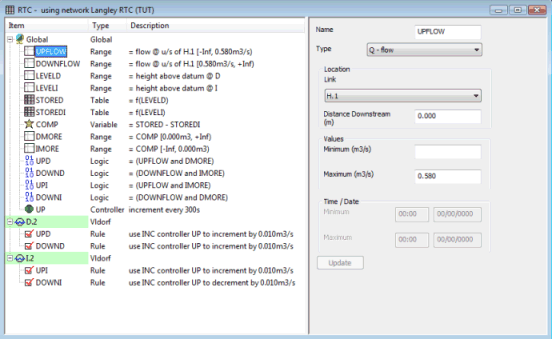

RANGE 1
UPFLOW
Range type: Q - flow
Location Link: H.1
Minimum: 0.000 m3/sMaximum: 0.580 m3/s
TRUE if flow in conduit H.1 is between 0.000 m3/s and 0.580 m3/s

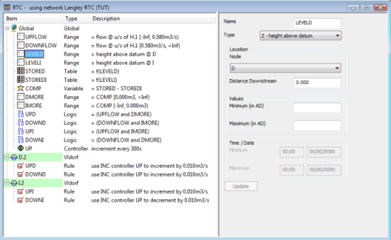

RANGE 3
LEVELD
Range type: Z - Height above datum
Location Node: D
Minimum: Maximum:
TRUE if Height above datum at Node D is between - / + infinity

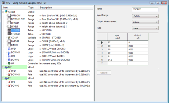

TABLE 1
STORED
Measurement: Volume
Input Range: LEVELD
Type: Linear
Input/Output grid: Height above datum vs Volume
Relationship between level and volume at Node D
TABLE 2
STOREDI
Measurement: Volume
Input Range: LEVELI
Type: Linear
Relationship between level and volume at Node I

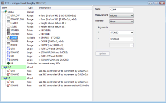

VARIABLE 1
COMP
Measurement: Volume
Operator: MINUS
Condition 1: STORED
Condition 2: STOREDI
VARIABLE 1 = Volume at Node D - Volume at Node I

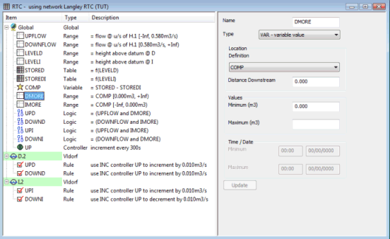

RANGE 5
DMORE
Range type: Variable
Location Definition: COMP
Minimum: 0.000Maximum:
TRUE if Volume at Node D is greater than Volume at Node I

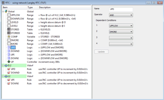

LOGIC 1
UPD
Operator: AND
Condition 1: UPFLOW
Condition 2: DMORE
TRUE if flow in conduit H.1 is between 0.000 m3/s and 0.580 m3/s AND Volume at Node D is greater than Volume at Node I

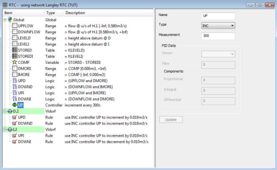

CONTROLLER 1
UP
Type: INC
Measurement Interval: 300
Measurement interval of orifice increment equals 300 s

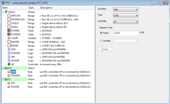

RULE 1
UPD
Condition: UPDRule type: CTRL
Controller: UP
Setpoint type: FIXED 0.010 m3/s
If the flow in conduit H.1 is between 0.000 m3/s and 0.580 m3/s AND Volume at Node D is greater than Volume at Node I, increment the regulator by 0.01 m3/s every 300 s.
