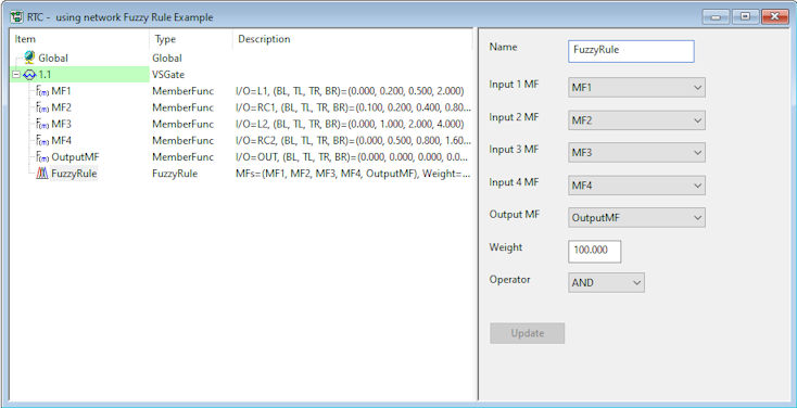

This pane is used to define a record for a fuzzy rule. The input and output fields are dropdowns which are populated with values defined in the Member Function pane.
The Fuzzy Rule pane contains the following fields:
Name The name of this rule. This must be unique for the regulator the rule is to apply to.
Input 1 MF This can be selected from a list which contains the output from the Member Function L1 Input/output option.
Input 2 MF This can be selected from a list which contains the output from the Member Function RC1 Input/output option.
Input 3 MF This can be selected from a list which contains the output from the Member Function L2 Input/output option.
Input 4 MF This can be selected from a list which contains the value from the Member Function RC2 Input/output option.
Output MF This can be selected from a list which contains the value from the Member Function OUT level at the target.
Weight The weighting of the fuzzy rule. Default is 100.
Operator
The AND or OR operator which is to be applied to this rule can be selected from the list.
AND - All conditions must be TRUE for the result to be TRUE. Otherwise the result is FALSE
OR - At least one condition must be TRUE for the result to be TRUE. Otherwise the result is FALSE
