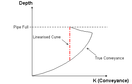

Don't linearise conveyance
In culverts, the conveyance is greater just before the culvert becomes full than at the point when the culvert becomes surcharged. This effect is most pronounced in wide rectangular culverts, and occurs due to the effect of the roughness of the roof of the culvert.
When this is option is unchecked (default), conveyance tables are linearised to the pipe full value to eliminate turning points in the conveyance function used by the solver. This is shown by the red line on the graph below. This results in the underestimation of flow capacity in rectangular culverts. However, it is more stable mathematically.
When this option is checked, the simulation engine does not linearise conveyance tables (see the black line on the graph). Using this option may result in instabilities when the conduit enters/leaves surcharge.
Conduit Conveyance
dont_linearise_k
