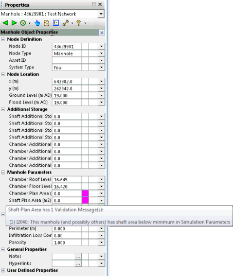

The Object Properties window is a modeless window providing a way of looking at all the data for a single network object in a structured way. It encompasses all the properties of the object, presented in a tree view. Properties are grouped in Property Groups that are entirely customisable.

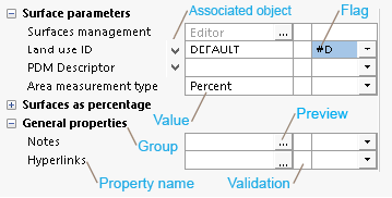

Property items are object-dependent and may contain the following parameters:
Property Item
Description
Name
Field description which (ideally) uniquely identifies the object property and value units.

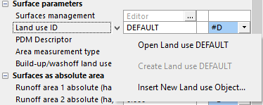

The button indicates that there is a non-visual object or item associated with the current network object. It also allows you to associate a new non-visual object if one does not already exist. Right-click on the button to display its context menu.
Example of an associated object context menu
The context menu may contain one or more of the following options:
  • The Open option is enabled when an existing non-visual object (whose name is displayed in the field) is already associated with the current network object. When this option is selected, the property window for the associated non-visual object is automatically displayed.
  • The Create option is enabled when the name of the non-visual object has been specified in the field but the non-visual object does not exist. When this option is selected, a new non-visual object, with the specified name is created, and its property sheet is displayed enabling you to specify its parameters.
  • The Insert New option displays the Add New Table dialog, which is used to specify the name of the associated non-visual object. Once specified, a new non-visual object is created and its property sheet is displayed, enabling you to specify its parameters.
Value
Either the object property value or a visual cue indicating that a preview of the object property value is available.
Tip: If there is not enough space for a property value in a box, click on the button to display more information (i.e. notes, hyperlinks).
Validation
Validation errors are displayed against each property by default.
A coloured icon indicates if the object property has a validation error or warning (If the cell is empty, there is no validation error or warning). Hovering over a validation icon with the mouse will display a tooltip with details about the validation error, such as the name of the network object where the anomaly occurred as well as the cause of the error/warning. See Tooltips section below for further details.
It is possible to hide the validation messages on the Object Properties Window (See Object Properties Window Settings dialog for more details).
Flag
Flag associated with the current object property value.

When some areas of the Object Properties window (e.g. DropTree, property, validation error) are hovered over with the mouse, a non-editable and non-customisable tooltip with some information of the item being hovered gets displayed.
Example of property tooltip
Example of validation error tooltip

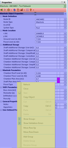

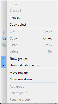

Context menu
Example of Context menu
When you right-click on a group, a property, a value, an error message or a flag on the Object Properties window, a context menu like the one shown above is displayed, allowing you to perform a large variety of tasks.
Depending on which item is clicked, or which view of the Object Properties window is displayed (network object properties, results properties or object type layout), some of the options may be disabled. See Using the Object Properties Window for more details on each of the available options on the context menu.
