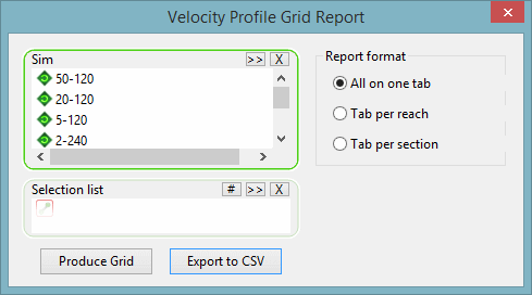

Velocity Profile Grid Report Dialog
This dialog is used to produce a detailed breakdown of flow, bulk velocity and wetted area for a selection of river reaches. Values are provided at each timestep for each river reach section as a whole and for individual panels that make up the sections.
Tip: The date-times included in the report can be restricted by setting the start and end times on the Replay Options Dialog. For this to take effect the Apply to Grid and Graph Tools check box must be ticked on the Replay Options Dialog.
The report can be displayed in a grid view or exported to csv format.
The dialog is displayed when the Results Grid report Velocity profile report menu option is selected.
Parameter Description
Simulations
Select the simulations to be analysed.
A grid report will be produced for each simulation selected.
Selection list
Optionally choose a Selection List or click the button to use the current selection in the active GeoPlan.
Results exported to the report will be restricted to river reaches in the selection list or current selection.
If no selection is made all river reaches will be included in the report.
Report format
Select the report format:
  • All on one tab: all results are displayed in a single tab in the grid report or exported to a single csv file per simulation
  • Tab per reach: results for each reach are displayed in separate tabs in the grid report or exported to separate csv files
  • Tab per section: results for each river section are displayed in separate tabs in the grid report or exported to separate csv files
Produce Grid button Click this button to display results in the Velocity Profile Report View
Export to CSV button Click this button to export results to csv file.
