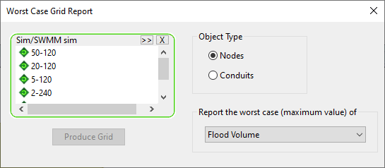

Worst Case Grid Report Dialog
This dialog is used to produce a report displaying the worst case for a chosen result parameter over a number of simulations.
The dialog is displayed when the Grid report Worst case report option is selected from the Results menu.
The items contained in the dialog are described in the following table:
Item Description
Sim/SWMM sim
A target box into which the simulations to be analysed can be dropped.
Object Type
The type of object for which the worst case is to be reported. Choices are:
  • Node
  • Conduit
Report the worst case
A dropdown list of result parameters for the selected Object Type for which the worst case is to be reported.
The options for nodes in InfoWorks simulations (Sim) are:
  • Flood Depth
  • Flood Volume
  • Level
The options for conduits in InfoWorks simulations (Sim) are:
  • DS Flow
  • US Flow
The options for nodes in SWMM simulations (SWMM sim) are:
  • Depth
  • Head
  • Total Inflow
The options for conduits in SWMM simulations (SWMM sim) are:
  • Capacity
  • Flow
  • Velocity
Produce Grid Generates the worst case report and displays it the Worst Case Report View.
