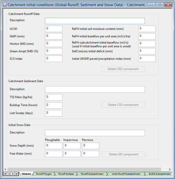

Catchment Initial Conditions Grid Window
To open a Catchment Initial Conditions Grid Window for editing, either drag the Catchment Initial Conditions from the Explorer window onto the main window background, or right click the item and choose Open from the popup menu.
Catchment Initial Conditions grid
The dialog has several pages. These pages are:
Globals
This page specifies global initial conditions for the current rainfall event for catchment runoff, catchment sediment and initial snow data. These conditions are applied to each subcatchment for which specific surface, subcatchment or snow pack initial conditions have not been defined.
Catchment Runoff Data (CRD), Catchment Sediment Data (CSD) and Initial Snow Data (ISD) are optional additional components of a rainfall event.
This section is used to define default initial values for the catchment runoff data.
The order of precedence for applying initial runoff conditions to subcatchments is as follows:
  • initial conditions specified on the Runoff Subcatchment page, Units Subcatchment page or ReFH Subcatchment page
  • initial conditions defined on the Runoff Surface page
  • initial conditions defined on this page
Description A description of the initial condition.
UCWI Urban Catchment Wetness Index for the Wallingford Runoff Model.
NAPI
API30 in mm for the New UK (Variable) Percentage Runoff Model and the UKWIR Runoff Model.
Horton SMS Soil Moisture Store (SMS) in mm for the Horton Infiltration Model.
Green-Ampt SMD Percentage Soil Moisture Deficit for the Green-Ampt Model.
SCS Index Catchment wetness for the SCS, CN and CNSWMM runoff volume models.
ReFH initial soil moisture content Cini value for the ReFH Runoff Model.
ReFH initial baseflow per unit area BF0 value used by the ReFH Runoff Model.This global initial baseflow will be applied proportionally to each subcatchment within the catchment area.
ReFH subcatchment initial baseflow(used if initial baseflow per unit is unset) BF0 value used by the ReFH Runoff Model. This global initial baseflow will be applied to each subcatchment within the catchment area.
DefConLoss initial deficit
Initial deficit value for the Deficit and Constant Loss Model.
Indicates the amount of water required to saturate the soil layer to the maximum storage.
Initial UKWIR paved precipitation index
PIpv value for the UKWIR Runoff Model.
Delete CRD component Deletes catchment runoff data.
This section is only relevant to Water Quality Simulations.
The information entered here determines the initial sediment mass on the catchment surface and the build-up time for which the Surface Pollutant Model or the SWMM Build-up/Washoff Land Use model is to be run before the start of the rainfall event. For the SWMM Build-up/Washoff Land Use model, the number of days since the last sweep can also be specified here.
The order of precedence for applying initial sediment mass values to subcatchments is as follows:
  • initial mass specified for the subcatchment on the Sediment Subcatchment page
  • initial mass for a Pollution Index defined on the Sediment Surface Page and applied to the subcatchment via a Land Use definition
  • global initial mass defined on this page
Note: If you do not include a Catchment Sediment Data component in a rainfall event used in a water quality simulation, the catchment surface will have no sediment on it at the start of the simulation. Not only have you not specified initial sediment depths, but you have not included a Buildup Time. The Surface Pollutant Model will not calculate any sediment build-up prior to the start of the simulation.
Similarly, the SWMM Build-up/Washoff Land Use model will not be able calculate the any sediment build-up prior to the start of the simulation, nor will it calculate any the removal of sediment that may occur during the simulation if a Last Sweep is not specified.
Description
TSS Mass
The initial sediment mass (kg/ha) for the total suspended solids on the catchment surface.
If you do not specify a global value, it will be treated as zero.
It is good practice to always specify a global value, and then override specific instances as described below.
Buildup Time
The time (in hours) for which the Surface Pollutant Model or SWMM Build-up/Washoff Land Use model is to be run, in order to calculate the sediment mass for each subcatchment at the start of the rainfall event.
Last Sweep (days) The number of days since the last sweep (surface removal of sediment) at the start of the event. This only applies to the SWMM Build-up/Washoff Land Use model.
Delete CSD component Deletes catchment sediment data.
