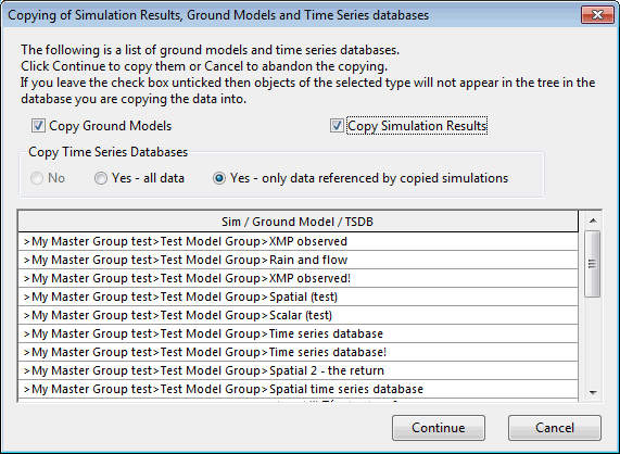

Copying of Simulation Results, Ground Models and Time Series Databases Dialog
Example of dialog when an item containing one or more simulations, ground models and time series databases is being copied.

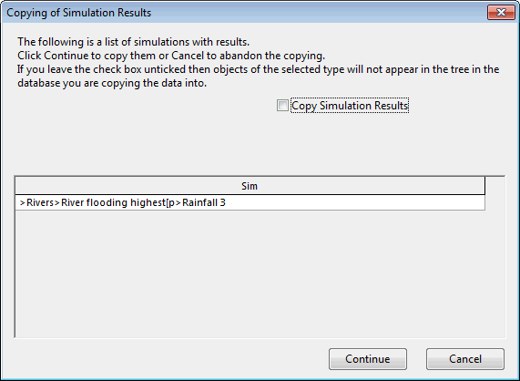

Copying of Simulation Results Dialog
Example of dialog when an item containing one simulation is being copied (no ground models or time series databases)

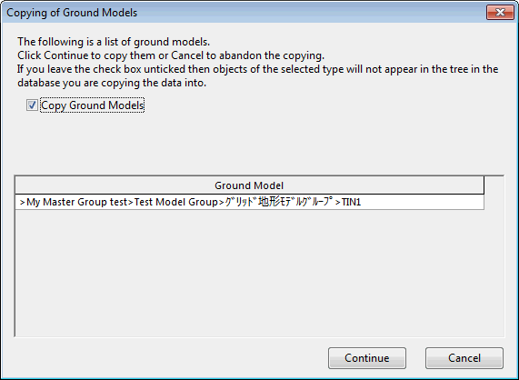

Example of dialog when an item containing one ground model is being copied (no simulations or time series databases)

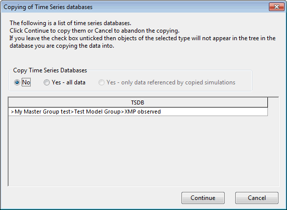

Copying of Time Series Databases Dialog
Example of dialog when an item containing one time series database is being copied (no simulations)
