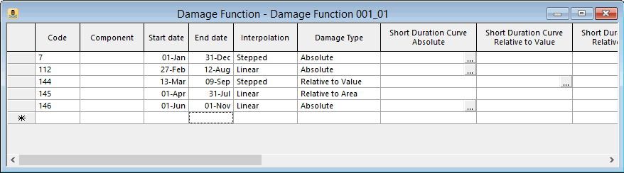

Damage Function Editor
This editor is used to view and edit a set of damage graphs defining the relationship between flood depth and damage values, where damage values are expressed as a monetary value used to calculate the cost incurred by flooding.
For each Damage Receptor you can specify:
Editor field Description
Code
Used in conjunction with Component field as a reference to associate damage curves with Damage Receptors.
Component
Used in conjunction with Code field as a reference to associate damage curves with Damage Receptors.
May be null.
Start date The date (day and month) that the damage curve generation is to start from. The format for the start date is DD-MON, where DD is a two digit number representing the date and MON is the first three letters of the month. The default start date is 01-Jan (the first of January).
End date The date (day and month) that the damage curve generation is to end on. The format for the end date is DD-MON, where DD is a two digit number representing the date and MON is the first three letters of the month. The default end date is 31-Dec (the thirty-first of December).
Interpolation Determines how the damage curves are displayed.The following options are available in the dropdown list:
  • Linear (default): the damage curve is drawn as a continuous curve
  • Stepped: damage curve is drawn as a step function
Damage type
Choice list of damage curve types:
  • Absolute - this curve represents the relationship between flood depth and total cost of damage
  • Relative to value - this curve represents the relationship between flood depth and cost of damage per unit value
  • Relative to area - this curve represents the relationship between flood depth and cost of damage per unit area
Short duration curve absolute
Enabled when Damage type is set to Absolute.
Lookup table of damage against depth to be used when flooding duration at the associated Damage Receptor is less than the Duration 2 threshold.
Click (Ellipse) to display the Damage Function Graph dialog.
Short duration curve relative to value
Enabled when Damage type is set to Relative to value.
Damage values will be multiplied by the associated Damage Receptor's Value.
Click (Ellipsis) to display the Damage Function Graph dialog.
Short duration curve relative to area
Enabled when Damage type is set to Relative to area.
Damage values will be multiplied by the associated Damage Receptor's Area.
Threshold for switching between short and Duration 2 curves.
Duration 2 relative to value
Lookup table of damage against depth to be used when flooding duration at the associated Damage Receptor is greater than the Duration 2 threshold.
Duration 2 relative to area
Duration 3 threshold Threshold for switching between Duration 2 and Duration 3 curves.
Duration 3 relative to value
Lookup table of damage against depth to be used when flooding duration at the associated Damage Receptor is greater than the Duration 3 threshold.
Duration 3 relative to area
Long duration threshold Threshold for switching between Duration 3 and long duration curves.
Long duration curve relative to value
Lookup table of damage against depth to be used when flooding duration at the associated Damage Receptor is greater than the Long duration threshold.
Long duration curve relative to area
Description Text field allowing description of curve to be entered e.g. description of structure that curve applies to.
