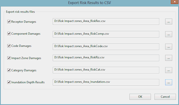

Export Risk Results to CSV Dialog
This dialog is used to export risk analysis results from Risk Analysis Runs to CSV format, and is displayed when you right-click on a Risk Analysis Results object and select Exportto CSV from the context menu.
Dialog description
Item Description
Receptor Damages If checked, exports the table of damage values for each Damage Receptor.
Component Damages If checked, exports the table of damage values for each damage function component.
Code Damages If checked, exports the table of damage values for each damage function code.
Impact Zone Damages If checked, exports the table of damage values for each risk impact zone.
Category Damages If checked, exports the table of damage values for each risk impact zone category.
Inundation Depth Results If checked, exports the table of inundation depths tabulated by Damage Receptor ID against return period.
Browses for a location to save the exported CSV files to.
OK Exports the selected files, in CSV format, to the chosen locations.
Cancel Cancels the export operation.
