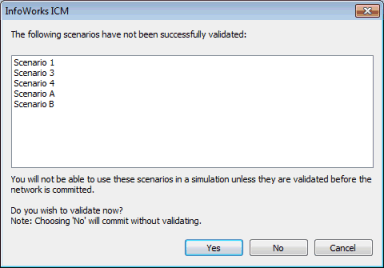

- The item is a network that has not been validated, or contains
scenarios that have not been validated. A dialog will be displayed offering the choice to commit with or without validating, or to cancel the commit process. A scenario that is committed without validation cannot be used in a simulation. Choosing Yes to validate will display the
Network Validation dialog. If validation is successful (i.e. no validation errors) changes will be committed and the validated scenarios will be available for use in a simulation. If validation of one or more scenarios is not successful, the dialog listing the scenarios that failed validation will be redisplayed.
