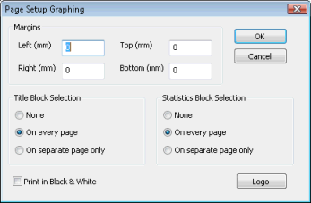

Graph Page Setup Dialog
This dialog is used to set up the printing options for a Graph.
it is displayed when you choose Page setup from the File menu when a Graph View is the Current Active Window.
Use the Margins options to control the graph margins.
Use the Title Block Selection and Statistics Block Selection options to control the display of the graph title and statistics table:
Click Logo to display the Print Setup Logo dialog. This dialog allows inclusion of a user defined title and logo, which will be printed at the bottom of the page.
