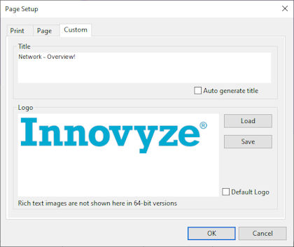

This dialog is used to set the title and logo options when printing the following views:
To display the dialog, click
Logo on the
Page Setup dialog for the view. (To display the
Page Setup dialog, select Page setup from the File menu.)
When printing the
GeoPlan Window, the options on this dialog are available from the Custom page of the
GeoPlan Print dialog.
Title options
A user defined or automatically generated title can be included at the bottom of the printout:
- Check Print title to include the title in the printout.
- Check Auto generate title to use a title generated by
InfoWorks ICM. An existing title in the Title text box will be overwritten by the generated title.
- To edit the title, uncheck the Auto generate title box and edit the title in the text box.
Logo options
The logo is a piece of
Rich Text Format text that can be included at the bottom of the printout:
- Click Load to load an existing Rich Text (.rtf) file created in an external package such as Microsoft Word.
- Alternatively paste text or images into the logo box and then click
Save to save the image as a Rich Text file.
- Check Default Logo to use the default logo set in the
Default Logo dialog.
