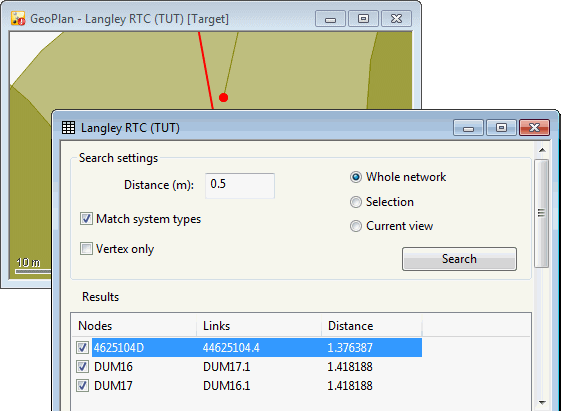

The proximity trace tool searches for nodes that lie within a specified distance of a pipe to which the node is not connected. This may indicate connectivity problems and identify locations where nodes should be connected into adjacent pipes.
The tool gives the option to analyse each occurrence, before correcting the connectivity by snapping the node to the pipe or the pipe to the node.
The following screenshot shows a proximity trace example:

- Edit the search settings if required:
Distance - the trace will look for nodes that fall within the specified search distance of a pipe to which the node is not already connected.
Search area options - select the area of network to be searched.
Match system types - check this option to only include nodes that lie within the search distance of a pipe of the same system type as the node.
Vertex only - check this option to search for nodes that fall within the specified search distance of a pipe vertex only.
- Click the Search button to list nodes that lie within the search distance of another pipe and match the criteria selected above.
