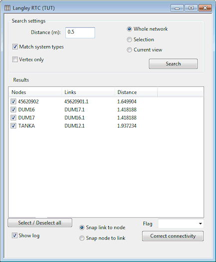

The Proximity Trace View is used as part of the Proximity Trace procedure. The proximity trace searches for nodes that lie within a specified distance of a pipe to which the node is not connected. This may indicate connectivity problems and identify locations where nodes should be connected into adjacent pipes.
The view is displayed by choosing Tracing tools | Proximity trace from the GeoPlan menu while a network is open.

Parameter Description
Distance
The trace will look for nodes that fall within the specified search distance of a pipe to which the node is not already connected.
Match system types
Check this option to search for nodes that fall within the specified Distance of a pipe of the same system type as the node.
If this option is unchecked, pipes of any system type will be included in the search.
Vertex only
Check this option to search for nodes that fall within the specified Distance of a pipe vertex.
Search area options
Select the area of the network to search:
  • Whole network - search will include all nodes in the network
  • Selection - search will include all currently selected nodes
  • Current view - search will include all nodes currently displayed in the GeoPlan
Search
Click the Search button to search the network according to the specified search settings.
The list of search Results will be updated.
Results
List of search results. Selecting one or more items from the list will select the objects on the GeoPlan Window and zoom the view in on those objects.
Column Description
Nodes
Lists the nodes detected within search distance of pipe that node is not connected to already.
Check the box next to the node ID to snap the node and adjacent link together when the Correct connectivity button is clicked.
Links
Lists a link within search distance of the detected node.
Distance Lists the distance between detected node and adjacent pipe
Select/Deselect all Click this button to check/uncheck all boxes in the Results list.
Show log
Check this option to display a log of changes made to the network when the Correct connectivity button is clicked.
Snapping options
Select the snapping option to be used when the Correct connectivity button is clicked:
  • Snap link to node - attempt to snap the adjacent pipes to each of the selected nodes
  • Snap node to link - attempt to snap each of the selected nodes to the adjacent pipe
Flag Select a flag to be applied to recalculated link fields (e.g. length, US node ID, DS node ID).
Click this button to correct the connectivity of the objects selected in the Results list.
Connectivity will be corrected by snapping the nodes and links together according to the selected snapping option.
