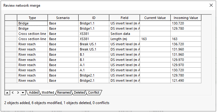

Review Network Merge Report
This report displays a summary of merged network objects and conflicts when you merge one network (the source network) into another network (the target network) using the Merge changes from another network option.
The objects that have been added, modified, renamed, or deleted in the target network are listed in the applicable tabs.
The report also lists the objects whose properties (Fields) have conflicting values after the merge. You can select whether to accept the Incoming Value or use the Current Value for each of the objects listed.
In the Conflict tab, the Incoming Value (highlighted in green) is applied to the target network. Clicking Undo applies the Current Value instead.
Selecting the object in the report highlights it in the GeoPlan.

Modified
Type The type of object that was modified.
Scenario The scenario where the object was modified.
ID The object ID.
Field The object property.
Current Value The object value before the merge.
Incoming Value The object value, applied from the source network, after the merge.
