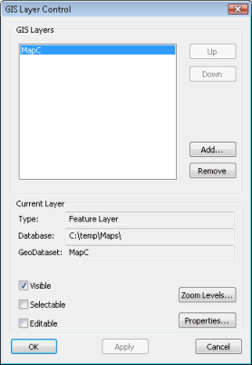

GIS Layer Control ArcEngine dialog
ArcGIS Engine GIS Layer Control dialog
GIS Layer Control ArcObjects dialog
ArcGIS Desktop GIS Layer Control dialog
GIS Layer Control Map Xtreme dialog
MapXtreme GIS Layer Control dialog
Use this dialog to choose how layers are displayed on the GeoPlan Window when using ESRI ArcGIS Engine, ESRI ArcGIS Desktop or Precisely MapXtreme .NET as the GIS component.
All layers can be moved up or down in the display order, added and removed, or temporarily hidden without removal. The layer can also be hidden automatically when the zoom level moves outside a certain range.
The GIS Layers box lists the layers that are currently loaded on the GeoPlan. The layers are added to the view in the order shown, with the layer at the top of the list being displayed above all other layers.

Add...
Adds a new layer.
Remove
Removes a layer from the display (the data is unaffected).

Visible
The layer is visible.
Selectable
Items in the layer can be selected.
(WMS layers and ArcGIS Server Map layers can not be made selectable).
Editable
The underlying data in the layer can be edited on the GIS Layer Information Dialog if this box is checked. See Viewing and Editing GIS Layer Data for more details.
(WMS layers and ArcGIS Server Map layers can not be made editable).
Note: ESRI ® Shape files (.shp) are not editable (Read-only Editable check box) when MapXtreme is the current map control.
Zoom Levels... or Map Scales...
Displays the Layer Visibility dialog, where the user can specify the level range over which the GIS layer is to be applied.
Properties...
Clicking the Properties... button will display the Layer Properties Dialog. This allows you to change symbol shape, size and colour for the current layer.
