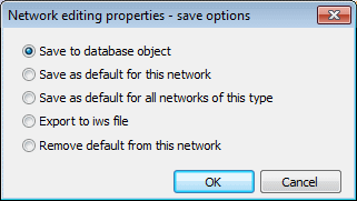

This dialog is used to save the current settings of properties associated with the network. The properties that can be saved are:
The dialog is displayed when the Save button is clicked on any tab or page of the GeoPlan Properties or the Section Properties dialog or when Save grid layout is selected from the Grid menu.
Saved properties can be loaded by clicking on the Load button present on any tab or page of the GeoPlan Properties dialog or Section Properties dialog or when Load grid layout is selected from the Grid menu.
Select the appropriate option (see below) and click on OK.
Radio-button Description
Save to database object
Save the current GeoPlan properties in the Model Group, as a Theme tree object.
(This option is disabled for Section properties and Grid layout properties.)
  • Click on OK.
  • This displays the Common Tree Selection dialog. Type in a name for the theme and select a location within the model group.
  • Click Save on the Common Tree Selection dialog. The Select Properties to Save dialog is displayed.
  • Checkboxes in front of themes and properties that have been added or edited for the network during the current InfoWorks ICM session are checked by default. Tick the check-box next to any other theme you want to save. Click on OK.
  • The saved themes appear as a tree object in the Model Group.
Save as default for this network
Save the current settings as defaults for this particular network. This applies to all users.
Note: Using this option results in the settings being saved as a network preference. In other words, this option will affect all users of that network once the network has been committed, and therefore it should be used with caution.
(The title bar of the GeoPlan Properties dialog indicates that theme and properties settings have been saved as network defaults).
Save as default for all networks of this type
Save the current settings as default for all the networks of the same type. This applies to the current user only, i.e. only the settings of the user who has selected this option will be affected.
No confirmation message is displayed.
Export to iws file
Export the current settings to an XML format file (.iws)
This file can be reloaded at any time . Please refer to the Reloading Saved Themes section of the Managing Themes topic for more detailed information.
Remove default from this network
Enabled when settings have been saved as default for this particular network.
Remove the current settings from the network default.
