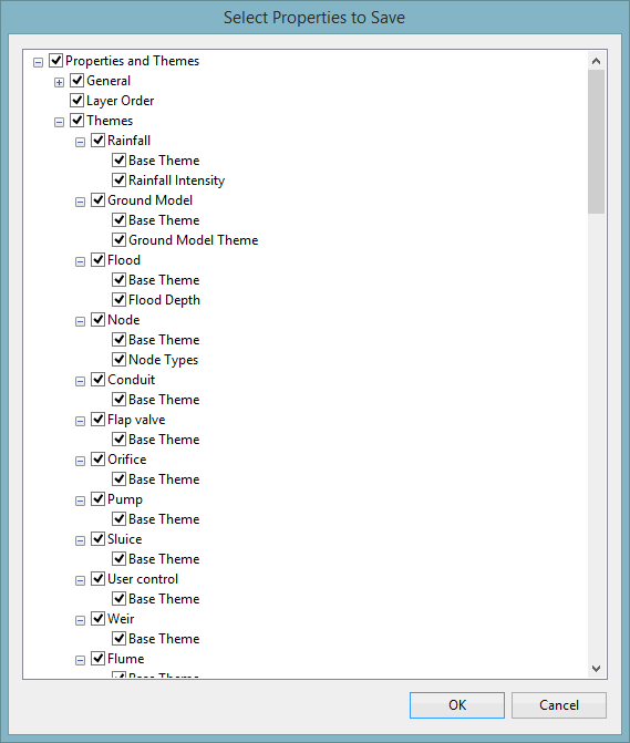

This dialog is displayed when you are either creating a new theme or saving a theme for future use.
- The dialog shows a list of all current properties and themes.
- The edited and new Themes / GeoPlan properties that have been set up for the network during the current
InfoWorks ICM session are ticked by default.
- Check the box next to any other property to be saved.
- Click on OK to save the checked items, and to close the Properties to Save dialog.
