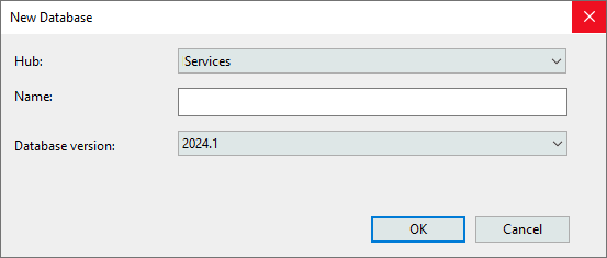

New Cloud Database dialog
This dialog is used to:
Dialog description
Item Description
Hub
The name of the hub where the new cloud database is to be stored.
Note: Only hubs which you have access to are displayed in the dropdown.
Name
The name of the database.
Database version
The database version for the new database. The available versions are listed in the dropdown.
Note: The oldest version available is 2023.0.
OK
Saves any changes and closes the window.
Cancel
Cancels any changes and closes the window.

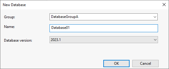

New Workgroup Database dialog
Dialog description
Item Description
Group
The name of a group that the workgroup database can belong to.
The names of groups already defined are contained in the dropdown.
Name
The name of a workgroup database.
Database version
The database version for the new workgroup database. The available versions are listed in the dropdown.
OK
Cancel
