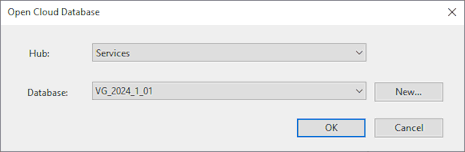

Open Cloud Database dialog
Item
Description
Hub A dropdown that displays the names of the hubs to which you have access.
Database A dropdown that displays the names of all existing cloud databases that are stored on the selected hub
New Opens the New Database dialog, in which you can specify the name for a new cloud database.
Update to
Displayed when updating a cloud database.
Lets you choose which version of the database that you want this cloud database to be updated to. The available versions are listed in the dropdown.
Note: The oldest version available is 2023.0.
OK Saves any changes to the dialog and closes the window. The selected cloud database will be opened in the Explorer window.
Cancel Cancels any changes to the dialog and closes the window.

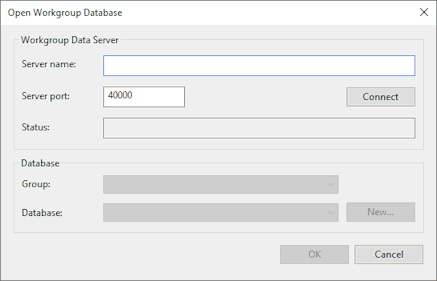

Open Workgroup Database dialog
Dialog description
Note: In order to use a workgroup database, the Workgroup Data Server software must be installed and running as a service on the machine hosting the database.
Item
Description
Item Description
Server name
The name of the machine hosting the workgroup database. This can be localhost to automatically find a server on the current computer.
Server port The machine port used to connect to the workgroup database. Typically 40000 for a local host.
Connect Used to connect to the server.
Status (read-only)
Reports whether the connection to the server is successful, and shows information about the server (for example Success: SuperNumbat 2021.1.0.31 Snapshot 20200810_0600 Aug 10 2020)
Database
This section is only available when the connection to the workgroup data server is established.
Item Description
Group
A dropdown of the names of any groups already created.
If workgroup databases have been assigned to groups, selecting the group here will only display, in Database dropdown list, the databases in that group.
New groups are created at the same time as creating a database (see the description of New below).
Database
A list of the workgroup databases available on the currently connected workgroup data server.
If a group is selected in the Group dropdown, this list will show only the workgroup databases in that group. If no Group is selected, the names of all workgroup databases available on the server, including (if applicable), the name of the group they belong to, will be displayed in the list.
You can choose one of the listed workgroup databases, or a new one can be created using the New button, described below.
New
Opens the New Database dialog, in which you can:
  • select or create a new group which databases can belong to
  • specify the name for a new database
  • select the version of the database that is to be used for the new database
Update to
Displayed when updating a workgroup database.
Lets you choose which version of the database that you want this workgroup database to be updated to. The available versions are listed in the dropdown.
OK Saves any changes to the dialog and closes the window. The selected workgroup database will be opened in the Explorer window.
