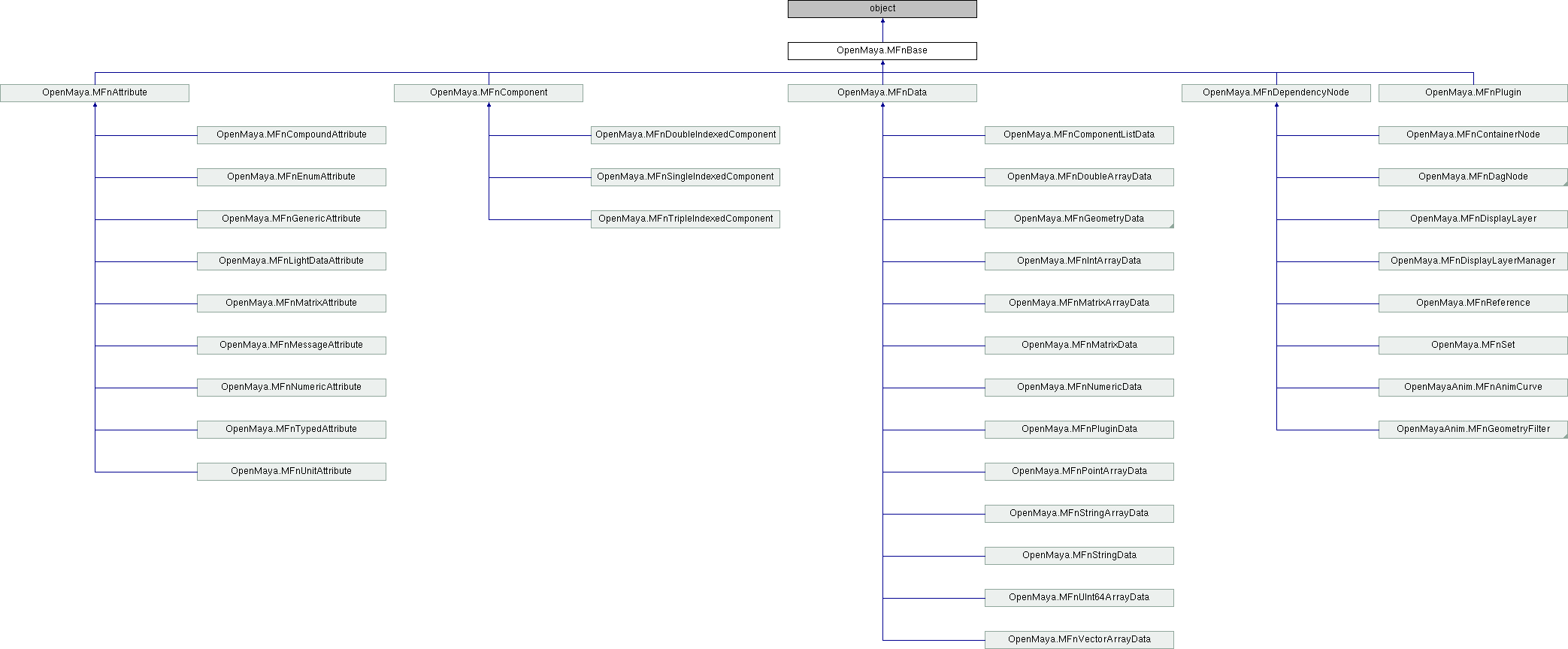

Inheritance diagram for OpenMaya.MFnBase:Public Member Functions | |

Base class for function sets.
