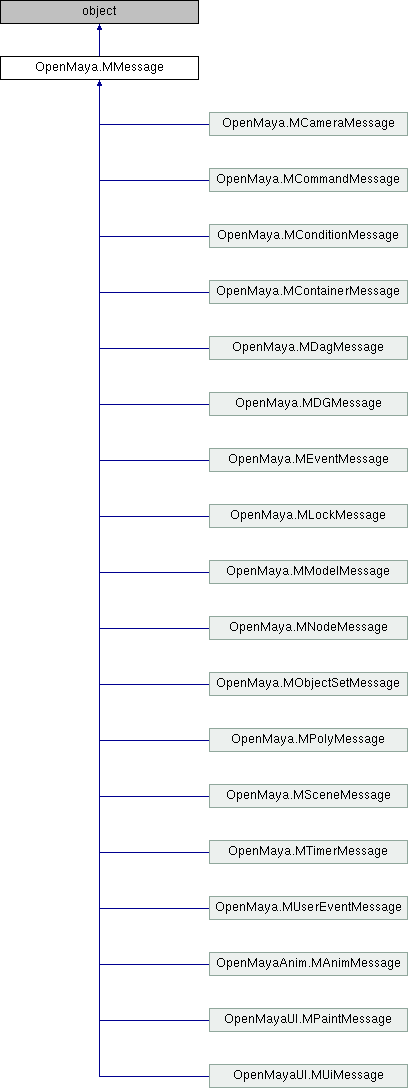

Inheritance diagram for OpenMaya.MMessage:Static Public Member Functions | |
