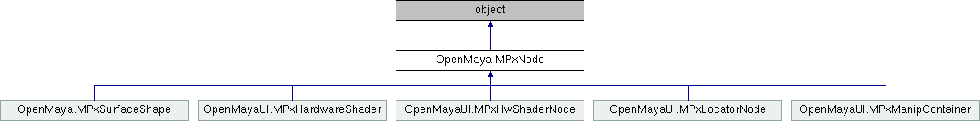

Inheritance diagram for OpenMaya.MPxNode:Static Public Member Functions | |

Base class for user defined dependency nodes.
