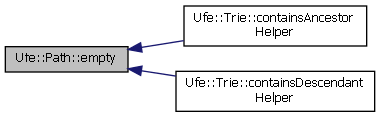

◆ empty()
bool Ufe::Path::empty ( ) const
Convenience method for size() == 0.
Returns
True if the path is empty.
Referenced by Ufe::Trie< T >::containsAncestorHelper(), and Ufe::Trie< T >::containsDescendantHelper().
Here is the caller graph for this function:
