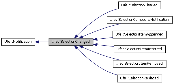

Universal Front End is a DCC-agnostic component that will allow a DCC to browse and edit data in multiple data models
Base class for all selection notifications. More...
#include <selectionNotification.h>
This class is the base class for all selection changed notifications.
Definition at line 26 of file selectionNotification.h.
