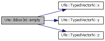

3D bounding box class.
Axis-aligned 3D bounding box class. Considered empty if the minimum in any dimension is greater than the maximum.
inline |
Create an empty bounding box.
Definition at line 183 of file types.h.
References Ufe::TypedVectorN< T, SZ >::vector.
inline |
Definition at line 190 of file types.h.
References Ufe::TypedVectorN< T, SZ >::x(), Ufe::TypedVectorN< T, SZ >::y(), and Ufe::TypedVectorN< T, SZ >::z().
