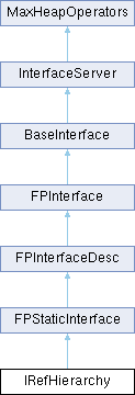

IRefHierarchy Class Referenceabstract
#include <irefhierarchy.h>
+ Inheritance diagram for IRefHierarchy:
