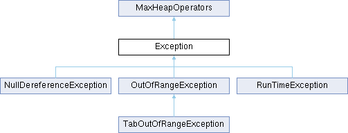

+ Inheritance diagram for Exception:

Detailed Description
Base exception class for 3ds Max.
This serves as a base class for other exception classes. Instances of this class own and make their own copies of the error message.

Reimplemented in TabOutOfRangeException, OutOfRangeException, NullDereferenceException, and RunTimeException.
