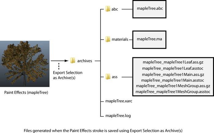

You can save Maya geometry in your scene and use it as custom archive geometry with XGen. You can also select Maya scenes and batch export contents of that scene to archive files. For example, you can create a tree with Maya Paint Effects, then save the polygon version of the tree as an
		XARC archive file along with its supporting files.
When you use
		Export Select as Archive(s) or
		Batch Covert Scenes to Archives, Maya creates an
		archive directory at the specified location. It contains the following files:
-  XGen
		  XARC archive file, which represents the geometry in XGen. These files store directory and file name information of the other archive-related files described below.
		  When you use
			 Batch Convert Scenes to Archives, saved archive files use the name of the source Maya scene file as a file base-name.
- Render proxy (ass.gz) and bounding box information (asstoc) files which are used to render the archive primitives as well as
		  Materials that are baked in the render proxy file are overwritten by materials assigned to the geometry in the scene. This means you can use SeExpr shaders to shade primitives on a per-instance basis.
-  Alembic
		  ABC files which store the geometry objects.
- Maya MA files, which contain the references to the materials assigned to the geometry. These material files are imported into the scene when you add the archive (XARC) file.
