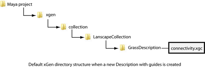

For example, after you set your Maya project and created the following:
- A Description named
		  GrassDescription and a Collection named
		  LandscapeCollection.
- On a polygon mesh named
		   landScapeplane.
- Using guides to place the primitives.
Maya generates the following default data structure for XGen.
