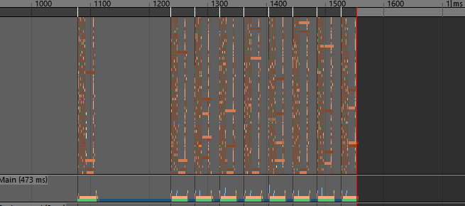

The Profiler lets you locate performance bottlenecks in your scene by recording and demonstrating in a graph the amount of time that each process consumes.
You can determine when to start and stop recording. You can also save your recording as a text file and reload it in the draw region at a later date. You can perform these tasks via the Profiler window or via the profiler MEL/Python command.

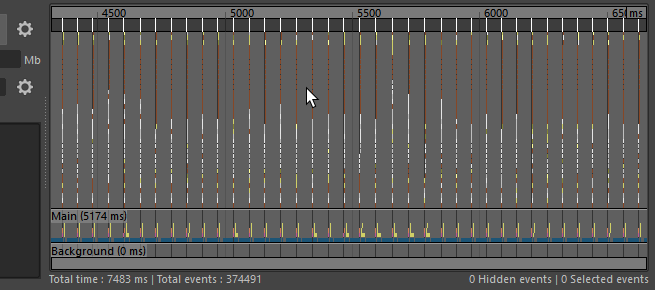

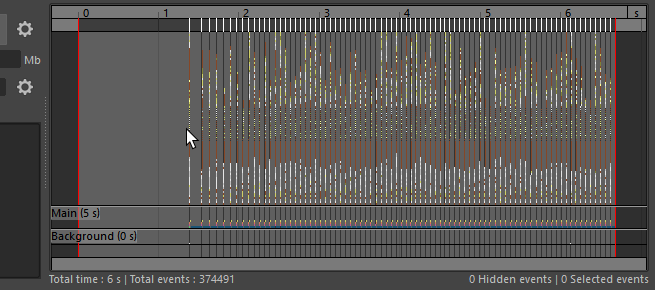

Use the hotkeys 1, 2, 3 to switch among view modes. These options are also available from the View menu.
| Navigate in the draw region |
Shift + Alt + right-drag up/down to zoom vertically. Shift + Alt + right-drag left/right to zoom horizontally.
