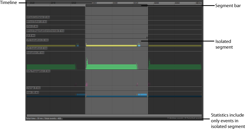

The Profiler graph marks the beginning and end of your recording with red vertical lines. In addition, your graph is divided into segments by dark grey vertical lines. These separators allow you to compare the segments, assess whether they are repetitive or similar, and query the number of segments in the profile.
For samples of some typical Profiler events, described, see Profiler interpretation examples. For a guide to what each Profiler color represents, see Profiler Colors.
Click the segment that you want to isolate on the segment bar. The isolated segment is now highlighted while the rest of the graph appears dark. When a segment is isolated, only the events in the segment are accounted for in the statistical information at the bottom of the Profiler (such as the total number of events).
profilerTool -q -segmentCount;
You can also isolate a specific segment or return to the default view using commands. See the profilerTool command documentation for more information.

In addition to the statistical information provided for each event (for example, its duration and thread ID, the bottom of the Profiler also lists the following information:
Hidden events are not included in the Total time and Total events count. If a segment is isolated, only the events in the isolated segment are included in these statistics. Isolated events are not considered hidden.
