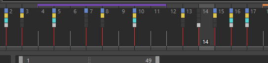

- Color Coded Keys
Colors indicate on which curve the key is set
Turn on this option to show key ticks with colored "beads" to indicate which animation curve affected by the key.
A Time Slider color coded key tick showing what each color indicates
- Set custom colors for Translation, Rotation, Scaling, and Other keyed attributes in the
Color Settings.

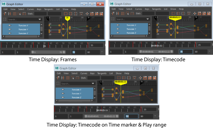

- Time Display
Select what format Time information appears on the Time Marker:
- Frames: Displays frames on all time rulers, current time markers, and input fields which display or accept time.
- Timecode: Displays video standard timecode on all time rulers, current time markers, and input fields which display or accept time.
- Timecode and frames on Time Marker: Displays video standard timecode on timemarkers while time rulers shown frames. This is the legacy display when
Timecode is set in the in the
Time Slider options in the
Time Slider Preferences
