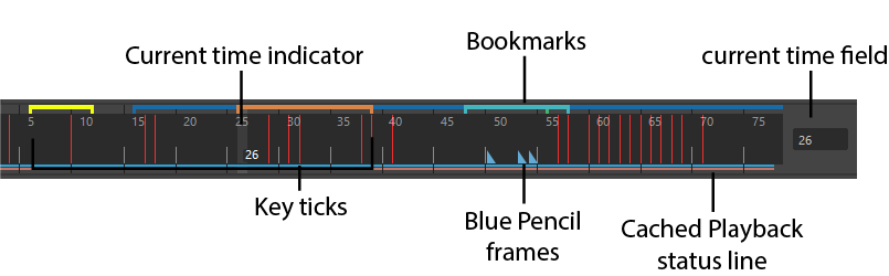

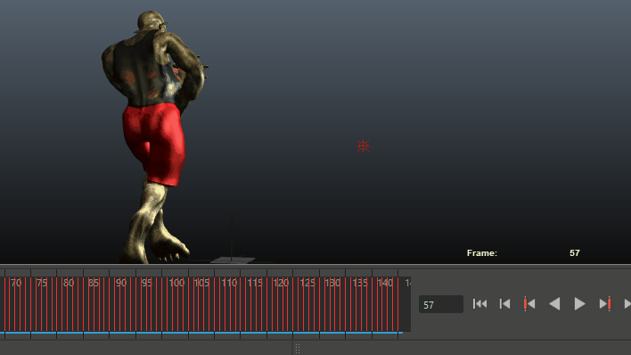

Dragging the Current Time Indicator on the Time Slider
The Current Time Indicator is a gray block on the Time Slider. You can drag it to move forward and backward in your animation.
Right-click the Time Slider to access the Animation controls menu, which provides easy access to common operations.

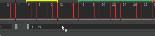

Key Ticks are red (by default) marks in the Time Slider that represent the keyframes you set for the selected object. When keys are selected, they appear white while highlighted blue (see Selecting keys on the Time Slider for an example). Breakdown keys are a special type of key displayed as green marks in the Time Slider.
Set a key on a selected object by pressing s. See Set Keys and Keyframe Animation for more about keying.
 is highlighted.
				Ctrl + drag to copy keys. See
				Edit keys.

Hover over a Time Slider Bookmark to view its name
		  Time Slider Bookmarks are colored tags along the top of the
		  Time Slider that flag events in your scene. Bookmarks are a way you can draw attention to specific moments in time which is useful when you want to focus or highlight specific areas or moments in your scene. You can move Bookmarks by

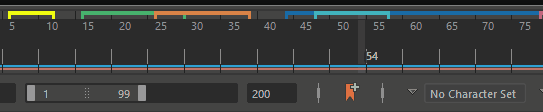

Add a Bookmark to a selected time range by clicking the Bookmark icon
		   in the
		  Range Slider or pressing
		  Alt (Option) +
		  T.
 in the
		  Alt (Option) +
		  T.
See Create a Bookmark for more.
Blue rectangles on the Time Slider are Blue Pencil frames
Shift + click to highlight one or more Blue Pencil frames on the Time Slider to rearrange them. Once highlighted, drag the arrows at either end of the highlighted area to grow or shrink the timing between the frames.

The blue and pink stripes on the Time Slider are the Cached Playback status lines
The blue line is the Cached Playback status for animation and the pink line is the Cached Playback status for dynamics.
Whenever you edit a scene that has been cached, the modified area of the status line temporarily turns dark blue to show the segment of the animation that is out of date before becoming blue again to show that the values have been updated.

The ruler markings and associated numbers on the Time Slider display time. To define the playback rate, select the desired Time unit in the Settings preferences (Window > Settings/Preferences > Preferences). Maya defaults to measuring time as 24 frames per second, the standard frame rate for film
The entry field to the right of the Time Slider indicates the current time expressed in the current Time unit. You can change the current time by entering a new value. Your scene moves to that location in time, and the Current Time Indicator updates accordingly.

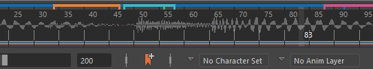

Audio Waveform in the center of the Time Slider
Right-click the Time Slider to open the Animation controls menu, where you can select the Audio rollout that gives you access to the Audio menu, where you can manage your Maya's audio settings.
When you import an audio file, its waveform shows on the Time Slider. See Display audio on the Time Slider.
