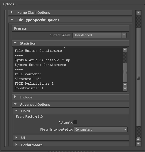

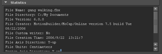

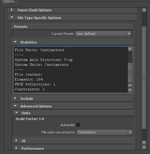

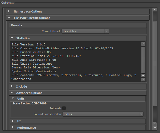

Statistics
The
Statistics window lets you view relevant meta information about the incoming (FBX) file and system (application) settings. Information varies depending on what is in the file. For example, you can use the statistics section to identify when the file was created, what direction the Up-axis faces, the file units used, and frame rate.
Note:
- Sometimes statistics are hidden below the window edge; use the scroll bar to view it.
- If the FPS (frame rate) is not a standard rate (24, 25, 30, 48, 50, 60, 100, 120 fps), it is not displayed. For example, an FBX file that uses a frame rate of 8 frames per second does not display in the Importer statistics. If the frame rate does not match between the FBX file and its host application, a warning appears next to the
System Frame Rate value. If the frame rate is not a standard rate, the Importer displays the system frame rate but no warning.

- Units
- The
Units option lets you view the conversion factor (scaling value) the plug-in uses as well as modify the conversion units.
This option automatically identifies, sets, and converts units of the incoming file to match units of the host application.
If this option is active, but the File Units match the system units, there is no need for scale conversion and the plug-in applies no conversion. The displayed Scale Factor is 1.0 in this case.
Note: This conversion affects only incoming data. This conversion does not change the settings in Maya.
- Scale Factor
- Displays the conversion value or
Scale Factor that the plug-in applies to the entire incoming scene.
- The Maya FBX plug-in compares the units used in the host application with the units used in the file imported to determine the
Scale Factor value. The plug-in then proposes a unit conversion that matches the system units in the host application. The displayed
Scale Factor is the result of this calculation.
- For example, if you import a scene from software that used centimeters as the working units to software that uses feet as units, the Scale Factor will be 2.54. This option is always active, but if your File Units match the system units, the plug-in does not apply a scale conversion. No conversion is applied. The displayed
Note: If you change the
File Units Converted to: option, you can modify the
Scale Factor value applied to incoming data.

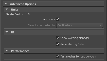

- Automatic
- Activate the
Automatic option if you want the Maya FBX plug-in to automatically identify, set, and convert units of the incoming file to match units of the host application.
- When you activate
Automatic, the
Scene units converted to option is disabled, although it shows the resolved unit and scale factor. If you disable the
Automatic option, the Scene units converted to option becomes available. When
Automatic is active but the file units match the system units, there is no need for scale conversion and the plug-in applies no conversion. The displayed
Note: This conversion affects only incoming data. This does not change the settings in Maya.
- File Units converted to
- Use this menu to specify the units to which you want to convert the file. Modifying this setting directly affects the
Scale Factor value applied to the incoming data. The Maya FBX plug-in looks at the
Settings/Working Units in the
Preferences window of Maya.
- The displayed
Scale Factor uses this unit setting for its calculation. This automatic behavior ensures that the plug-in respects units, and proper scaling is applied by default.
Note: Verify the
System Units your Maya scene uses so that you can control whether the Maya FBX plug-in needs to scale your scene.
- If you import a file that is in the same unit setting as the
Working Units of your Maya scene, there is a match of units and the plug-in displays “1.0” as the
Scale Factor. No scale conversion is applied.
- If the units do not match and your Maya scene is empty and/or changing the
System Units is not a concern, change the
Maya System Units to match the
File Units used in the incoming file before you start to import. This results in a match of units,
Scale Factor of “1.0”, and no scale conversion is applied.
- For example, if you import a file that is in centimeters into a Maya scene set to inches, it results in a
Scale Factor
of 0.3937008. In this case, the incoming data is scaled down to match the scene's unit system.
Note: If the
Scale Factor is 1.0, no scaling is applied. If the
Scale Factor is greater than 1.0, the incoming data is scaled up. If the factor is smaller than 1.0, the incoming data is scaled down.
- If, with the previous example, you do not want to change the
System Units of your Maya scene and do not want the plug-in to scale your incoming data, you have another option:
- Change the
File Units Converted To option to match the
File Units. This results in a
Scale Factor of “1.0”, and no scaling is applied, even though units do not match between the file and the
Maya System Units.
- UI
- These options let you set display options of the UI. This lets you show or hide the
Warning Manager.
- You can customize these display options, save them as a new preset, and share this preset file. See the Editing presets section in
FBX Import options topic for more information.
- Show/Hide Warning Manager
- This option lets you disable the
Warnings and Errors
dialog box that appears during the import process. The
Show Warning Manager
option is active by default.
- When something unexpected occurs during the conversion, the plug-in reports an error. This error occurs because the Maya FBX plug-in encounters an unknown behavior and the conversion is going to produce an unexpected result.
- The Maya FBX plug-in uses errors and warnings to alert you of conversions and potential problems during the import process.
- When the Maya FBX plug-in must apply a conversion to the source data for it to be in a format that the destination application can read, a warning is reported. This warning is not the indication of a problem, but instead exists to provide a report of conversions that have been applied to the incoming data.
- Generate log data
- Deactivate the
Generate log data option if you do not want warning and error information written to the log. However, if you do deactivate this option, the file name and time stamp are still recorded in the log.
- Normally, it is recommended to leave the
Generate log data option active, which is the default, as this helps you identify problems with file conversions. Occasionally, some batch import/export create very large warning/error files, and in this case you might want to disable this option.
- Performance
- The
Performance options let you detect performance issues with your file.
- Test meshes and remove bad polygons
- Activate this option when you want to test your mesh objects for degenerate polygons, such as two-sided polygons, single vertex polygons, and so on. The Maya FBX Plug-in will evaluate the scene for any degenerate polygons and remove them from mesh.
