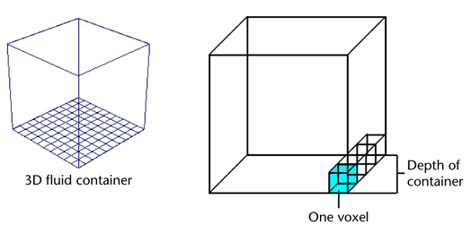

Fluid containers are divided into three dimensional grids, and each unit of one of these grids is called a voxel.

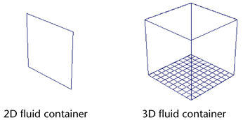

3D fluids can be very large, making the solve for their dynamic fluid behavior very slow. This is due to all the extra data required to define them. In many cases, the effect you want can be achieved using simpler, less memory intensive 2D fluids.

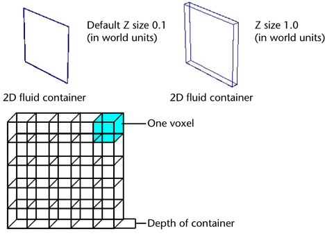

A 2D fluid container is a 3D fluid container with a depth of one voxel. The size of that voxel is determined by the Z size of the container.
As the Z size gets bigger, any Density in it becomes more opaque. By animating the Z size you can mimic the 3D effect of an object moving through the fluid without the extra rendering time it would take to have a full-fledged 3D fluid.
A 3D fluid container is a fluid container with a depth of two or more voxels.

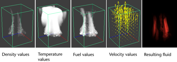

You define a fluid effect by putting values for any or all of the following fluid properties into its container: Density, Velocity, Temperature, Fuel, and Color.
You can use different methods to define these properties, depending on the effect you want and whether the effect is dynamic or non-dynamic. See Defining the contents of a fluid container.
Density represents the material property (the substance) of the fluid in the real world. Think of density as the geometry of the fluid. Where the Density values are highest, the Density appears more opaque. You can create a non-dynamic fluid effect using only Density, or you can combine Density with Velocity and other properties to create dynamic simulations.
Velocity affects the behavior of dynamic fluids by movingDensity, Temperature, Fuel, and Color values inside the container. Velocity has both magnitude and direction values. Direction defines the moving fluid values’ path.
For dynamic simulations, Maya calculates the Velocity values based on the forces you apply to the simulation. However, you can also set a fixed Velocity path, using Velocity as a force to push property values around in the container.
Velocity is required for dynamic fluid simulations.
Temperature affects the behavior of a dynamic fluid, causing it to rise or react.
For dynamic fluids, Fuel combined with Density creates a fluid where a reaction can take place. Density values represent the substance being reacted, and Fuel values describe the state of the reaction. Temperature can igniteFuel to start a reaction (for example, an explosion effect). During the course of the reaction, the Density and Fuel values get smaller until the reaction is complete.
This property applies color to Density. Color appears only where there is Density.
This example combines Density, Temperature, Fuel, and Velocity values to create a dynamic simulation of a flame.
