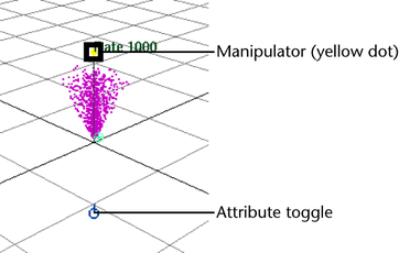

To use a manipulator on an attribute
A yellow attribute manipulator appears next to the emitter object. Dolly towards the manipulator to get a clearer view. Initially the attribute manipulator controls the Rate setting. An attribute toggle also appears near the emitter. It controls which attribute you can manipulate.
Each time you click the attribute toggle, you display a different attribute manipulator. The manipulator is an icon (often a dot) you typically drag to change its value. The color of the manipulator and attribute toggle indicates which is active. Yellow is active, blue is inactive. For more details manipulators, see Use manipulator icons.
After clicking the attribute toggle a number of times, you’ll see a display mode where all the manipulator icons are displayed without the attribute names. When you click an icon in this mode, the attribute name appears next to it. You can then manipulate the attribute. Click the attribute one more time and you’ll see the first manipulator displayed in the cycle—the Rate attribute.

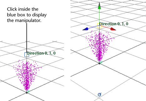

Click inside the blue box. A manipulator identical to the Move tool appears. Drag the center to move in all directions, or drag one of the arrows to move with directional constraint. This manipulator appears only for directional point emitters.

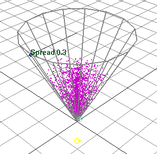

Drag the dot icon roughly perpendicular to the emission direction. This displays a cone that indicates the Spread angle. When you drag the dot, a line appears in the workspace indicating the direction you can drag.
