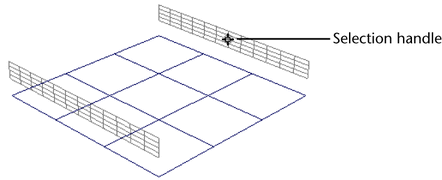

You can edit these attributes after you create the Surface Flow effect by selecting the surface flow selection handle and opening the Channel Box or the Attribute Editor, Extra Attributes section.
You cannot directly rotate or translate manipulators, because they automatically adjust to any changes in the shape of the surface. However, you can edit the Location attributes to move them along the surface.

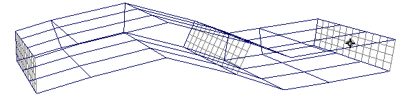

By default, the manipulators are displayed as smooth bands that wrap around the base surface in exactly the shape that you specify. The actual shape that the effect uses depends on the Manipulator Resolution value that you set at the time you created the surface flow.
To see that shape, turn on the Show True Manip Shape attribute. This does not affect the way that the surface flow moves the particles. It simply lets you see how accurate the simulation is trying to be.

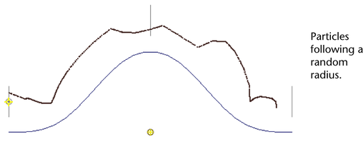

Sets the amount of random changes in the particle emission radius, so that particles spread beyond the flow manipulator loft. Use this attribute to create a more natural effect.

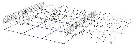

Controls the position of each flow manipulator, measured in U or V. You can move manipulators anywhere along the surface in any order.

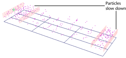

Typically, you adjust the manipulator locations to affect the particle speed. Particles slow down between manipulators that are close and speed up between manipulators that are distant.

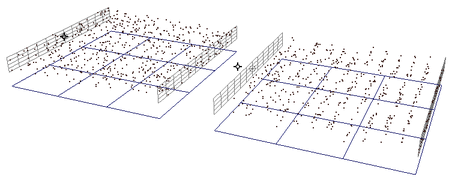

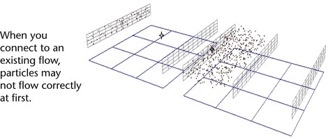

You can connect flows from separate surfaces so they share the same particles. The workflow is different depending on whether you create flows at the same time or start with an existing flow.
To create connected flows
The effect creates one flow per surface, with the particles flowing in the order of selection.
By default, the Min and Max Age Ratio settings are evenly divided among the flows. As a result, a gap appears if the surfaces are separated. Edit the Min and Max Age Ratio settings if you want the particles to fill the gap.
To connect an existing flow
There will be one flow per surface, but the particles may not flow correctly. Correct the flow of particles using the following steps.
