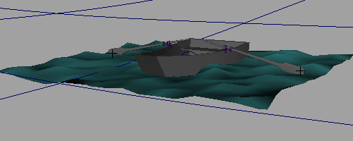

You can make an object float like a boat by adding a boat locator to it. Standard boat locators behave like dynamic locators, but also rotate in X and Z. Motor boat locators include throttle, rudder and roll attributes to realistically simulate the motion of a motor boat.
For an example of a boat in an ocean or pond, you can select a preset ocean or pond from Fluid Effects > Get Ocean/Pond Example. For example, Rowboat.ma.

Boat locators follow the motion of the ocean in the Y direction, but additionally rotate in X and Z to allow the boat to pitch and roll in the waves.
