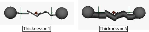

The Thickness attribute determines how fat the lightning is. It specifies the radius of the circle that gets extruded along the curve that makes up the lightning.

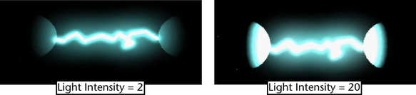

When you create lightning, a light at the center of the lightning is also created, which casts light on surrounding objects. The default intensity of the light is based on the Glow Intensity attribute, and the difference between the Lightning Start and the Lightning End attributes. The Light Intensity attribute multiplies this default intensity. Increase the value of Light Intensity to increase the lighting of the surrounding objects.

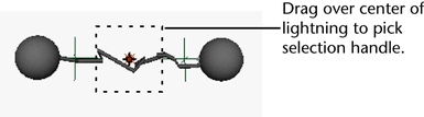

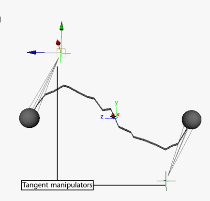

You can adjust the direction the lightning moves away from the start object or toward the end object using the tangent manipulators.
To position the lightning

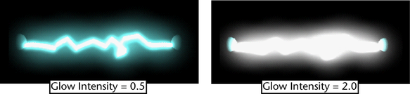

In the lightning shader, Color, Incandescence, and Glow Intensity are set by the lightning attributes and cannot be changed in the shader. You can adjust the other shader attributes.
