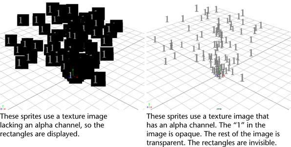

Lets you display a texture image or image sequence at each particle. Each particle can display an identical or different image or image sequence. Depending on the type of texture image you use, you can use sprites to create effects such as smoke, clouds, fog, and stars.
A sprite appears as a small rectangle until you map a texture image to it. The image faces the camera directly regardless of the camera’s position or orientation.
If the texture image lacks an alpha channel, the image is opaque and occupies the sprite rectangle. If the texture image has an alpha channel, the sprite uses the image’s transparency. To avoid displaying the rectangle, you must make the peripheral parts of the original texture image transparent.

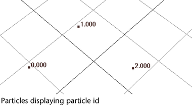

Displays the current values of any attribute of the particle object. This is useful when you want to know the value of an attribute such as velocity at a certain frame. By default, Maya displays particle ids for the Numeric render type.

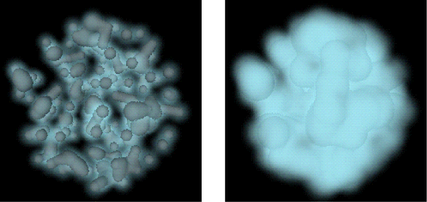

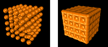

Displays particles as metaballs. Metaballs are spheres that blend together to form surfaces. Blobby Surfaces appear only in software rendered images.
To avoid this, you can increase the particle rendering quality by selecting the particle object and making the following render settings. Open the Maya Software tab of the Render Settings window. Under Number of Samples, set Particles to 4, or to achieve very high quality particle rendering, set Particles to 8.

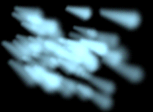

Displays particles as blurred or cloudy metaballs. Metaballs are spheres that blend together to form surfaces. Clouds appear only in software rendered images. See Create raytraced shadows with particles.
Displays particles as tubes. Tubes appear only in software rendered images.

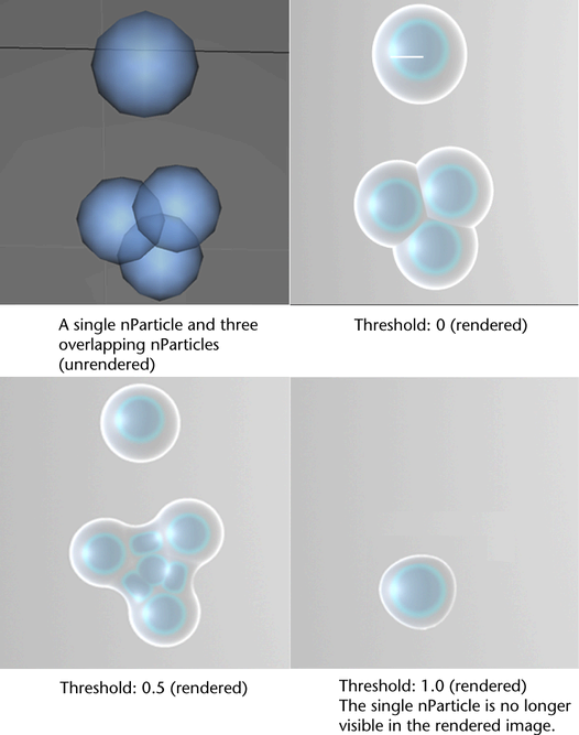

Determines the smoothness of the surface created by overlapping Blobby Surface nParticles. Threshold is based on the overall density of overlapping nParticles. Each nParticle has a density of 1 at its center, which then falls off to a value of 0 at the nParticle's edge.
Threshold controls surface blending between Cloud or Blobby Surface spheres. Threshold is important in determining the appearance of rendered nParticles.
For example, when creating Liquid Simulation nParticles, Threshold determines the size and smoothness of the nParticle’s rendered surface by controlling the density of the overlapping particles. The following images show a rendered nParticle object at different Threshold values.
