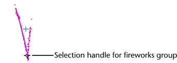

The fireworks group and rockets selection handles appear.

Start by selecting the fireworks group selection handle.

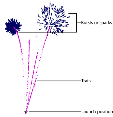

Affects how fast all rockets burst, and, consequently, how wide the bursts appear. Each particle in the burst has a random speed, and this speed is the maximum.
Each burst consists of a number of streaks randomly distributed between these two values.

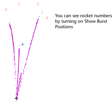

Shows you the rocket burst positions by displaying the rocket particle ID number in the view panel.
Shows you the rocket launch positions by displaying the rocket particle ID number in the view panel.

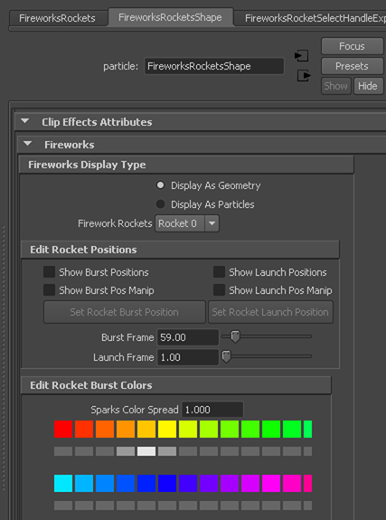

You can edit the following on a per rocket basis:
To make these edits, you must first select the rocket attributes in the Attribute Editor, FireworksRocketShape node.

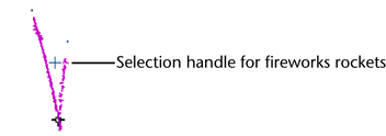

To select rocket attributes
If the rockets selection handle becomes hidden behind the rocket trails, try drawing a selection box in the center of the Fireworks effect.

You can see the number of each rocket by turning on the Show Burst Positions or Show Launch Positions checkbox.

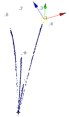

To edit rocket burst or launch positions
Remember to click Load Attributes if the Attribute Editor is not refreshed.
If the node in the Attribute Editor changes, you must turn off Auto Load Selected Attributes, under the List menu. To redisplay the FireworksRocketShape node, select the rocket group and click Load Attributes.

To edit rocket colors
Sets the number of colors used in the rocket’s burst sparks. The spread appears on either side of the main color you choose in the sparks color palette.
Enables you to select a spread of colors for the rocket’s burst sparks. Click the rectangle under the main color you want, and the other colors in the spread are chosen from either side of it.
By default, the palette consists of colors chosen in consecutive order around the color wheel. You can change the palette one color at a time by clicking the color square, which opens the Color Chooser. Or, you can use the Remake Color Palette option.
