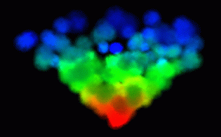

You’ll see the particle color textured by the ramp as the particles age.

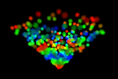

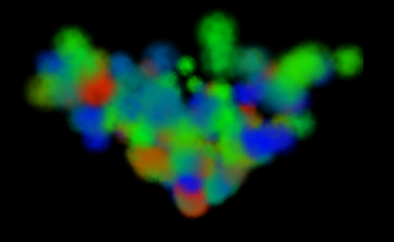

Noise is applied to the placement of the ramp creating randomness in the red, green, and blue particles.
Notice that the particles cycle through the ramp more than once as they age.

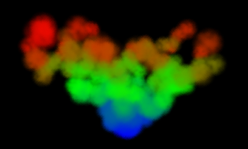

particleShape1.rgbPP = << mag(particleShape1.velocity) / 10, 0.0, 1 -mag(particleShape1.velocity)/10 >>;
This tells Maya to change the particle color from blue to red as the velocity increases.
