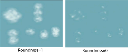

Controls the noise’s irregularity. The smaller the value, the less rounded the shape.
The following animation shows the Roundness attribute changing from 1 to 0.

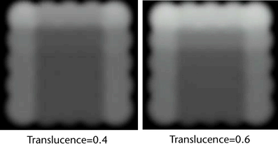

Specifies a scaling factor for density that is used to compute shadows only. The larger the translucence value, the more light penetrates. The formula is:
density * (1 - translucence)
The following animation shows the Translucence attribute changing from 0.4 to 0.6:.

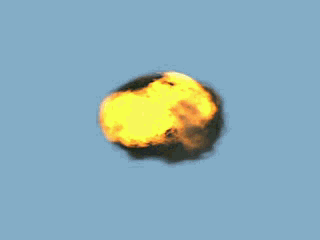

This cloud shader uses Surface color and Surface Shading Shadow to create an explosion.
Volumetric particles use pre-illumination, which evaluates the lighting at each particle’s center by default. This can sometimes cause popping if the illumination changes too fast in an animation, and is especially noticeable if Surface Shading Shadow is on.
